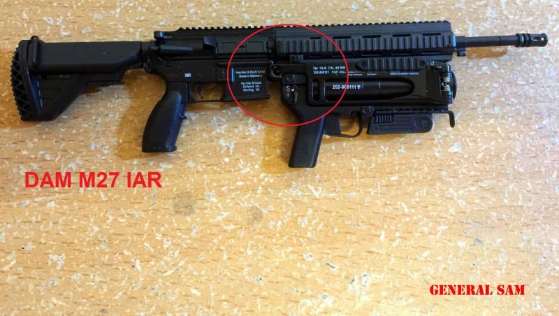

In the right column, we have Dam hk416, Dam M27, Dam 78006 m4 ris II.
As you can see from the following pictures, the DAM M320 fits perfectly on DAM rails. No problems at all

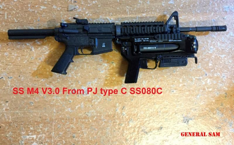

So now for the test, does the m230 fit onto the SS rails ? The answer : YES ! But there is a slight issue. The DAM m320 was made to fit perfectly on to DAM rails, not so for SS. of the 3 m320s i tested, 1 of the m320s were EXTREMELY hard to slide onto the soldier story rails. I have considered this to be an anomaly. The rest were slightly hard to slide , but not impossible. It was chicken feet after i applied some silicone lubricant to the rails.

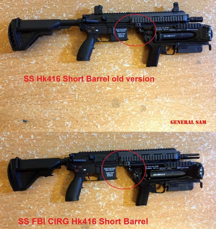

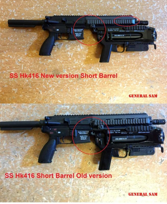

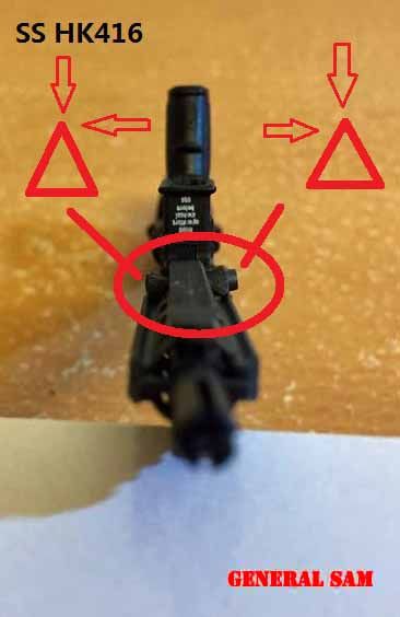

As you can see from the pictures below, something on the SS hk416s is blocking the insertion of the DAM m320 , and i am unable to fully seat the DAM m320.
upon further investigation, i realized this is due to the design of the SS Hk416 rail pins.
On the DAM hk416 and M27, the rail pins are rectangular and flat,
However on the ss Hk416s, the rail pins are triangular, as seen in the picture below.
The tips of the triangular pins are blocking the full insertion of the DAM m320 and preventing me from fully seating the m320 against the Hk416 magwell. HOWEVER, if you use some force, you are able to force the m320 in. What happens if you do it correctly, is that you are forcing the triangular pins upwards, making some space for the m320 to slide in fully.
The downside of this is, once the m320 is seated fully, the triangular pins clam downwards onto the dam m320, making it very difficult to extract the m320 from the rail.
I have attempted to file down the triangular pins but to no avail. But as mentioned above, adding some silicone lubricant will aid in this attempt.

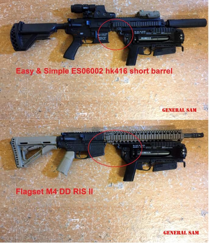

The Easy & Simple rails, and the Flagset Rails fit on the m320 easily. Do note that as the easy and simple hk416 uses similar triangle pins as the ones on the SS hk416, you will encounter the same issue, unable to fully seat the m320 against the magwell, unless you use force to divert the pins upwards to make space.

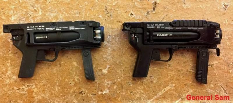

On the left we have the Zy toys m320, and the DAM m320 is on the right.
Both look good with crisp wording, but DAM pulls ahead. The spring that rotates the m320 tube on the DAM version is a real metal spring, while the ZY toys version is just painted to look like a spring.
Both Fire selectors are movable.

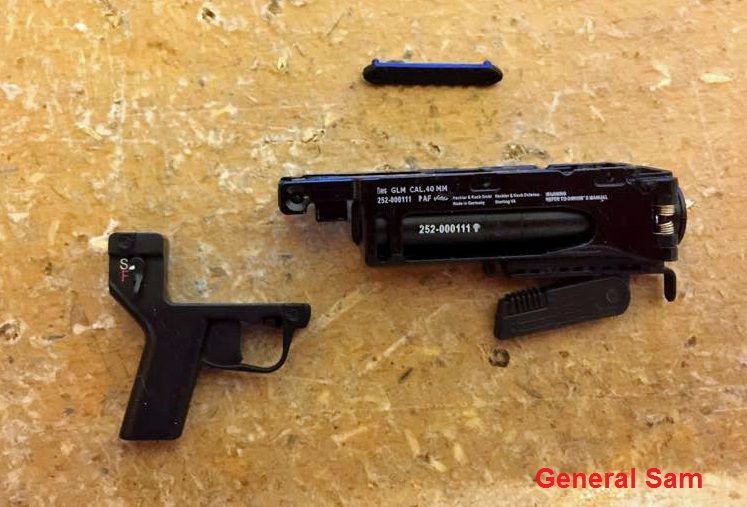

The DAM version can be further disassembled. I am not sure why i was able to remove the trigger piece and if it was a factory issue ( no glue ). Fear not, it is fixed on quite tightly and is held by friction, it wont come off unless you actively try to yank it off. The rail section is detachable as well.
