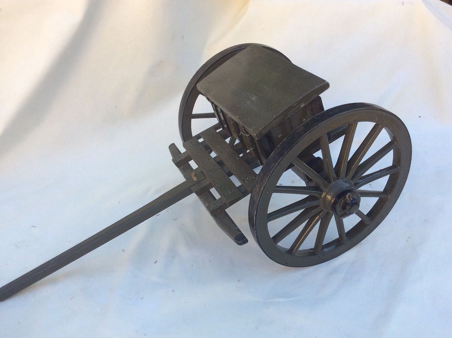

Last year, I made a phenomenal buy on ebay, that included numerous Civil War figures, loose uniforms and equipment and a SST 10 pound Parrott Rifle. I hit "Buy it now" after the first two pictures, and only afterwards did I see that it included a 1/6 scale LIMBER! The limber was a heavy, all metal piece painted a darker green and had few details. The wheels aren't convex, but it works for me. I believe it came from Gillmor Ordnance, a company that makes firing cannon in different scales:
Gillmor Ordnance
The first thing it needed was the large handles at either end of the chest. These were shaped from brass rod and soldered in place.
Then I Dremeled down the pintle piece and drilled a hole, which had to be slotted, and made a pintle hook, which keeps the cannon from coming un-hitched.
Wire pieces were shaped to create the irons on the front for attaching the harness. The limber had a pole underneath in front that supported it when parked, and this was made from an old paint brush and two small eye bolts. BGT didn't have their grease bucket available, so I made one from a piece of thick dowel.
Then the whole thing was re-painted olive drab (close to the original color) to match the SST cannons better. The pole was too short and had no detail, so it was lengthened with a dowel and I made the hardware. I hope to detail the inside of the chest, but for now, I covered the lid with Bare Metal Foil and added straps for a canvas tarp.
Please don't wait for me to make up six horses with harness. This baby is permanently PARKED! But there are plans to build another limber and caisson for background. Time will tell.

magnificent! I can imagine a six-horse team and the cannon itself, the visual impact would be overwhelming....
I hope you can find a suitable spot in the museum for it, it's really a showpiece.

Thank you both. I hope to get some action shots put together soon. It's been a long time coming.
Greg, this one is staying home. I have on cannon at the museum, but there isn't room. Besides, I have my own plans for it with my battery!
