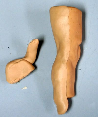

Arms and Knees :
Many of my tropical figures have new arms and sometimes knees : these are modelled in Fimo and inserted into the DML "chassis ".
Modelling them obviously requires anatomical reference , and skill and practice , but if you fancy trying it , you can see my method from these pics : use the tile as a support ( you don't need an armature , the limb is supported by the tile ) model as much as you can get at , which is generally about 2/3rds of the circumference , fire it, then take it off the tile , carve down the other side and model on the rest , then fire that :~
These limbs can be fitted to the stumps : the knees I join with Fimo extensions that fit into the sawn-off thighs ; the arms the same way , or with pins into the epoxy-filled upper arms.You lose the knee and elbow articulations , but keep all the others :~
If you model limbs and hands in Polymer clay like this , they retain enough flexibility to fit weapons or whatever in the hands, if you are careful.
Recently , since " Bake'n'Bend " Sculpey became availble, I add a proportion of that to the mix , which adds considerably to the flexibility .

Hi Tony,
Considering how much of the actual figure you use and how much you build from scratch, what do you gain by starting with a plastic figure rather than a wire armature?
- Ivan.
Captain Eyestrain
1,195 Posts
Using a commercial body you keep all the articulation ( except for the elbows and knees ) , which is essential for posing successfully.
Besides , it's quicker, believe me , to have a body to build on , than to start from scratch.
Thirty years ago I made static, non articulated figures for museum displays, using a wire armature , and it took a lot of work .
They were also heavy , and above a certain thickness polymer clays tend to crack, especially after repeated firings.
A complete set of bodymods as above , even with new arms and legs, can be done in a matter of hours.
A completely new body, solid and unposeable, takes days, and has to be made with removeable limbs to enable the clothes to be put on.

Hi Tony,
That makes sense. Now don't you need to have removeable arms to get the clothes on for these figures as well? I was thinking that just a padded wire armature would be sufficient for the figure under the clothes since it wasn't visible anyway. Your figures show elbows, arms and legs, but a padded armature should work for a figure that is entirely covered by a uniform. I have always wondered why folks agonise over modifying a figure for better range of motion when the final result was a static model with none of the body visible.
I guess the biggest difference is that you are really building models and I am just putting together toys. The lack of mobility in the elbows and knees would bother me.
Thanks.
- Ivan.
Captain Eyestrain
1,195 Posts
Discussion Starter · #9 ·
The arms are removeable , and I make some spares, so that when I do a photoshoot I can change them around to vary the pose. It may seem surprising, but even with rigid knees and elbows you can vary the pose enough to make the figure interesting.
The fact is, I can't tolerate visible joints, and if I make a shortsleeved figure I just have to have realistic arms. You only need maximum articulation if you are going to play with them a lot, and that never bothered me.
